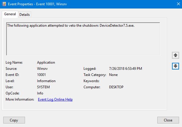

I have been having the same problem and by following this information I found out it was my Cyberlink Media Expresso 7.5. This is a program I very rarely use so I removed it and the problem is gone. See image below.
Mystery app preventing Windows 10 shutdown after update.
Since a Windows 10 update a few weeks ago, when I go to shut down, it says it is closing and there is an app running ------- but there is no app running So I wait for it to close that nonexistent app, and after a few minutes, I am back to the computer being ready to work, not shutting down. When will a new update fix this? Yesterday's update did not fix this. It is not a serious problem, but it is annoying to have to click "Shut down anyway" to really shut down. What is this app that hides itself and won't quit?

The app that prevents your device from shutting down is most likely part of the updated system or could also be part of the security certificates that was installed after you performed Windows Update. We can determine which specific app is that by ending the task of the same icon in the Task Manager. However, let's try to run the System File Checker tool first to fix and correct any improper settings in your computer system. Please note of the result.
We would like to ask for the screenshot of the shut down page where it says that there's an app which prevents you from shutting down, and also the screenshot of your Task Manager under the Process tab. This is for us to have a better picture of the issue and determine the appropriate advice.
Additionally, we also suggest that you run Power troubleshooter for possible help. To do that, simply type troubleshoot in the search field or Cortana, click on it in the search result, click on Power, then click on the Run the troubleshooter button.

2018-02-10T19:33:16+00:00 Write down the name it says is running
before you log off or restart, go to task manager and see if it is running or located in processes, details, startup or services tab and force it off or disable it if possible. But good to know what it is to determine how to address it.
Thanks for your reply. That's the thing. It just says "This app", but does not name the app (no clicking or hovering gives a clue). When I go to the task manager, the only app listed that is running is the task manager.
What I am saying is that since XP, occasionally you could get an app running when restarting or logging off and would be prompted to wait for it to close or force it closed to continue to log off or restart. It is no big deal really as long as you can force it to shut down.
