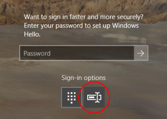

    When at the login screen, do you have a set of "Sign-In Options" buttons like this:
    If so make sure the the password option is selected and not the pin option.
