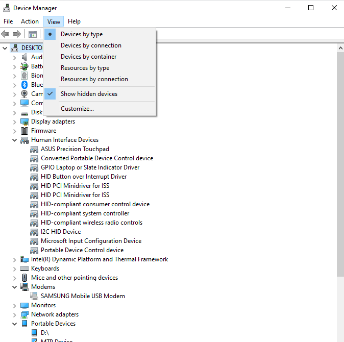

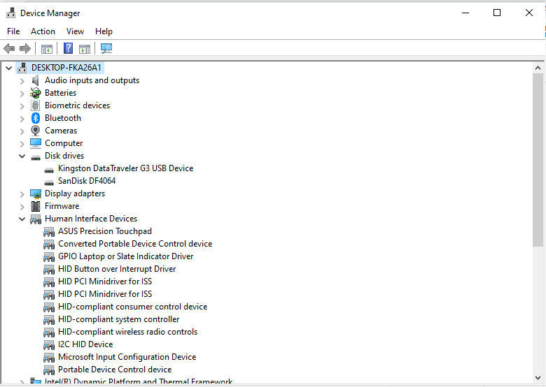

    2020-06-25T00:00:24+00:00
    I dropped the laptop (Asus) out two days ago, and when I open the device manager i don't find the USB input devices or HID touch screen driver.
    Could anyone help me?... I have tried everything
