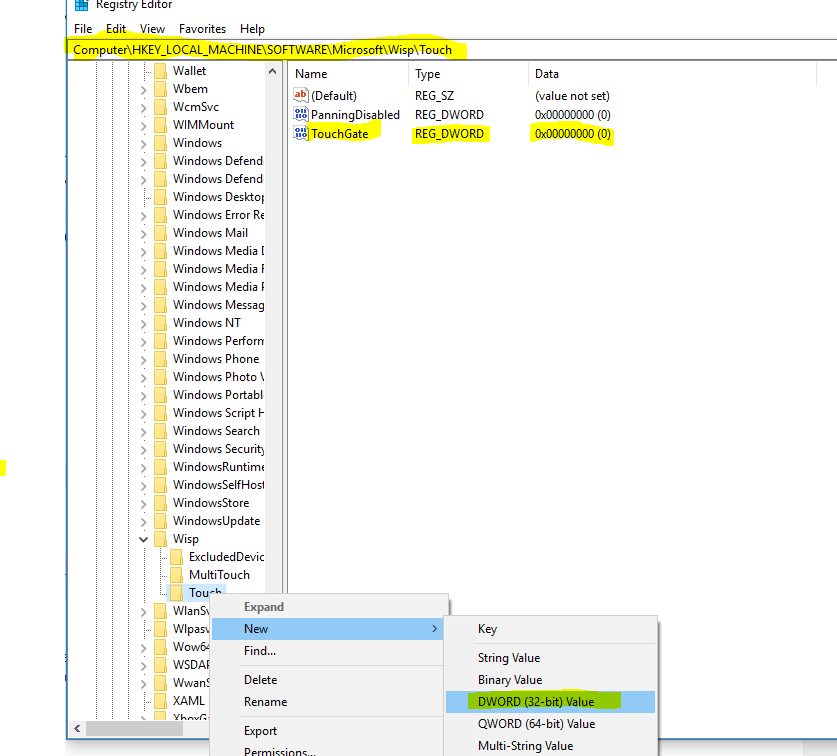

    2019-01-12T18:34:56+00:00
    For the registry to update all users you need to login with Administrator account.
    1. Open regedit
    2. Navigate to HKEY_LOCAL_MACHINE\SOFTWARE\Microsoft\Wisp\Touch     ( right click on this key and click on New as seen below and select Dword to create a TouchGate . )
    3. Create a new DWORD (32 bit) with the name TouchGate
    4. Doubleclik on the newly ceated DWORD and make sure it has the value 0
    (0 = touch disabled, 1 = touch enabled)
