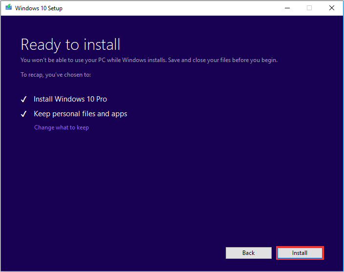

    I have had this twice now on my Surface Book 2 with two different builds of Windows 10.. since purchase, there is only one real fix until MS make the Windows 10 Updates more stable. and that is to re-install Windows.
    I have spent countless hours trawling through forums trying this, editing that, deleting this nothing works, the drive Partition size I wouldn't even try to change those, first time I resolved this with a complete backup of my data etc. and a complete re-install of Windows 10, but then I had to spend a long time re-installing all my apps and restoring my personal files etc. from backups.

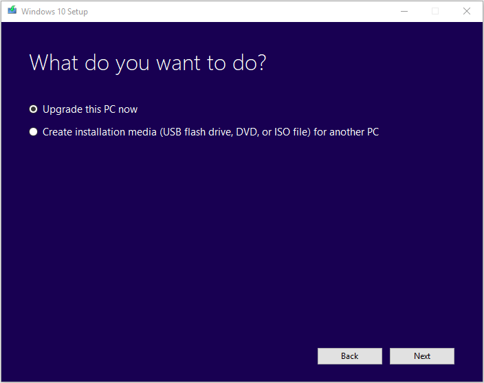

    via web browser go to aka.ms/winup or https://www.microsoft.com/en-us/software-download/windows10
    Download the "Create Windows 10 installation media" tool and run it, follow the prompts, and you will eventually get to a screen similar to this, you don't need to create an ISO/DVD or USB image...

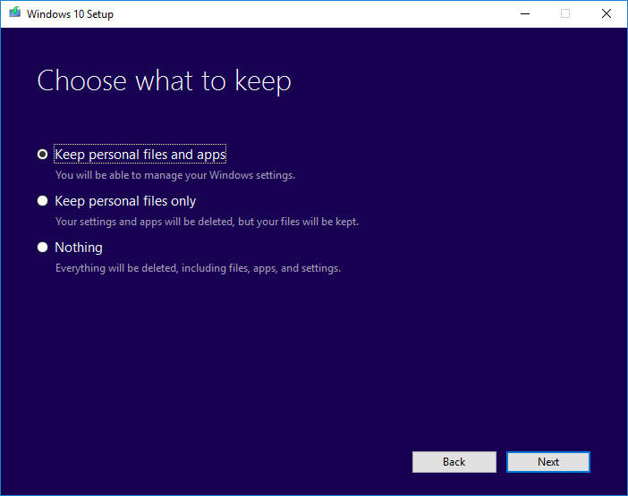

    you can safely do this and keep all personal data files and installed apps without any problems, with this tool there are now THREE options, you need to select the one KEEP PERSONAL FILES AND APPS
    Wait for the software to download what it needs etc.

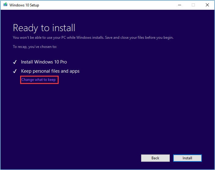

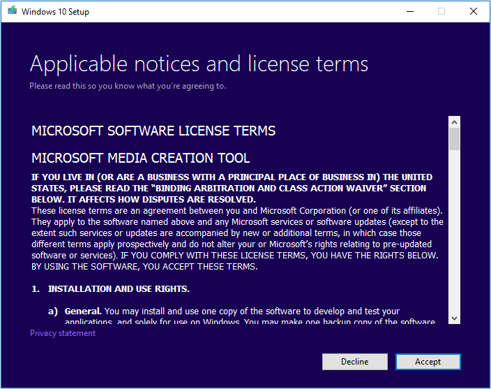

    Let it download the Windows 10 Image etc. then accept the license info, and let it get the updates etc. then click install (you can check the 3 options if needed)
    At this screen just hit INSTALL and wait, you will be back up and running without any major loss of data or apps:
    The latest version allows in an in-situ repair without the need for USB/DVD Media. The Steps are logical and you just need to follow them, if you are sensible you will still backup and important data, but Roberto B. from the
    Surface Support team assured me that it was safe, and so far I am back up and running without having to spend 2 days restoring data and re-installing apps!
    This is NOT a fix, more of a Workaround, but this worked for me, and I am happy to say I am back up with minimal fuss, but it would help if this had not happened in the first place! ;-) thanks Roberto!
