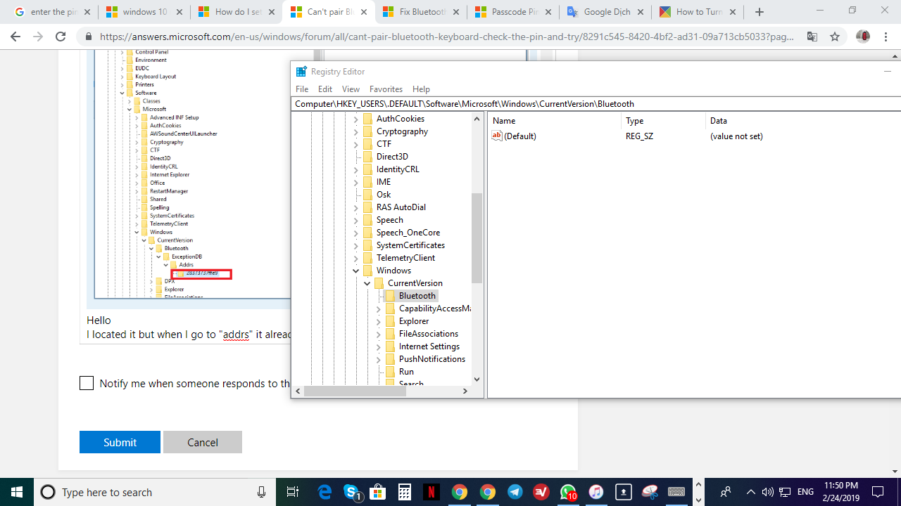

    Step 1: Click on Windows Start Button
    Step 2: Type "Run"
    Step 3: When the Run Command appears, Type "Regedit"
    Step 4: Follow the screen below and locate... Computer\HKEY_USERS.DEFAULT\Software\Microsoft\Windows\CurrentVersion\Bluetooth\ExceptionDB\Addrs
    Step 5: Delete the folder under Addrsas shown in my screenshot below
    Step 6: Try pairing your Apple Keyboard again, a new Apple Keyboard PIN will now be generated. Quickly enter the PIN you see on the Apple Keyboard and press Enter.
    Example is as shown below. Let me know if it worked for you.
    Hello
    I located it but when I go to "addrs" it already empty. Then I try to connect my magic keyboard again but it still can not connect. I'm using pc windows 10 with magic keyboard, my magic mouse and new airpods work fine with my pc, just only magic keyboard won't work. I bought this keyboard few months ago, it work perfect until wins10 get new updates as I can understand. Now I'm using magic keyboard just like a wired keyboard. My pc can only connect to magic keyboard in that way, hope you can help me go through this. Thanks you.
