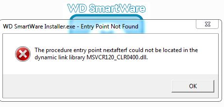

After doing a windows update getting the below error message while logging in .
"The procedure entry point nextafterf could not be located in the dynamic link library MSVCR120_CLR0400.dll"
what does it mean and how we can resolve it and now I notice that the Skype for business search is not finding anything as well .

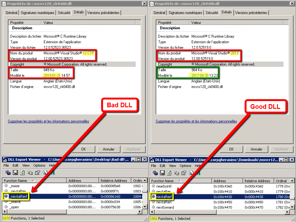

2019-08-14T19:38:10+00:00 In our company this issue is affecting us a lot lately, we don't know how this happens, but there are two bad DLL library files with the same name, that end up randomly on our users machines.
The files two files are located in the following folders:
C:\windows\system32
C:\Windows\SysWOW64
The bad files not only are smaller in size than the good ones (having 255, respectively 296 less function definitions), but they have also renamed functions i.e. preceded with an underscore or even more (see attached image), which is why the entry points can't be found:
**Bad file:**C:\windows\system32\msvcr120_clr0400.dll => 850 KB (255 less function definitions)
**Bad file:**C:\Windows\SysWOW64\msvcr120_clr0400.dll => 856 KB(296 less function definitions)
The simplest and fastest solution that we found for fixing this issue, is to keep a pair of good DLL libraries at hand, and simply replace the two bad files with the good ones (make a copy from an unaffected machine):
**Good file:**C:\windows\system32\msvcr120_clr0400.dll => 9 71 KB
**Good file:**C:\Windows\SysWOW64\msvcr120_clr0400.dll => 965 KB
Besidethis related case about Skype, we found out that these two files affect the SCCM Software Center and the Bentley Connector with that message "The procedure entry point nextafterf could not be located in the dynamic link library MSVCR120_CLR0400.dll", as well as Autodesk products like all AutoCAD versions and all verticals with a FATAL ERROR up front.
After replacing the two files, everything goes back to normal,
Hope this helps,
Constantin
