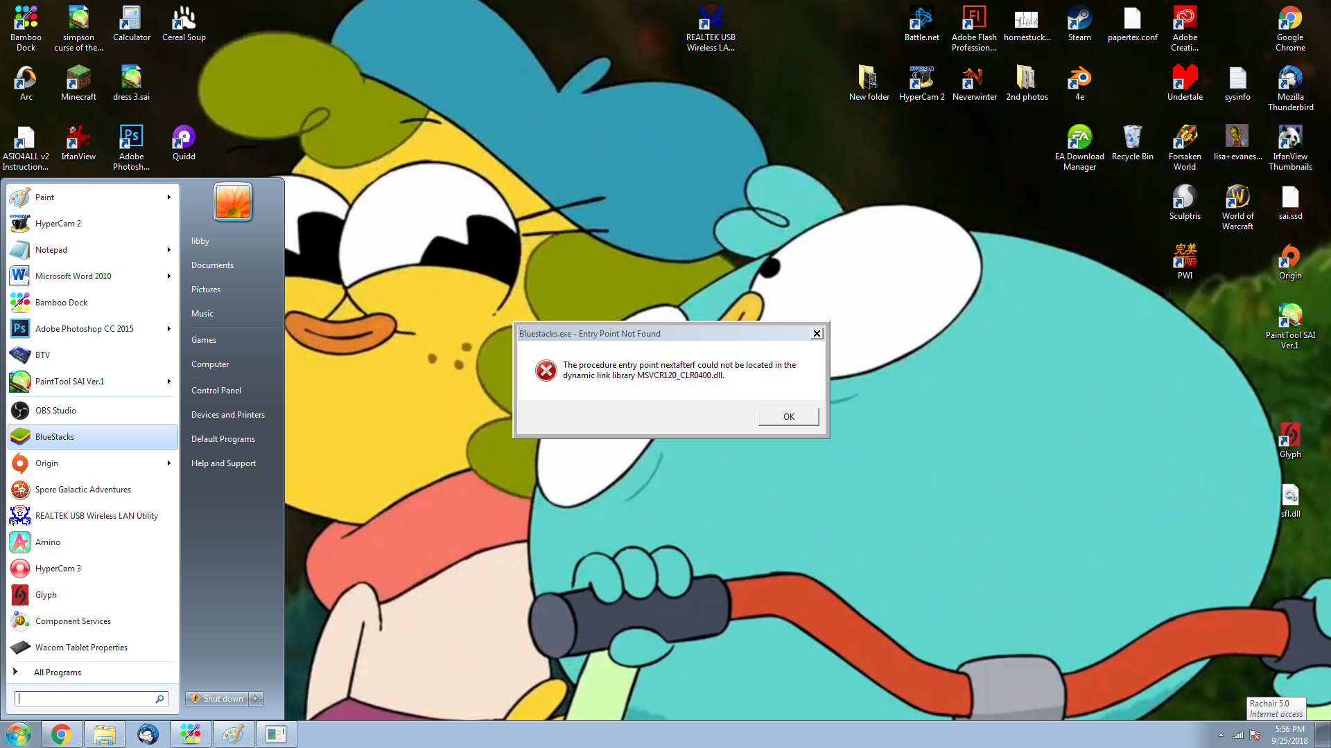

    I am receiving the same error and it is affecting two of my programs.
    The names of these programs are Bluestacks and Discord. I will provide all information on my problem in the images below.
    I unfortunately cannot show Discord as I attempted to uninstall and then reinstall it in hope of fixing the issue. When I attempted to reinstall it, that error message came up instead, and it never properly reinstalled. The one you see now is for Bluestacks.

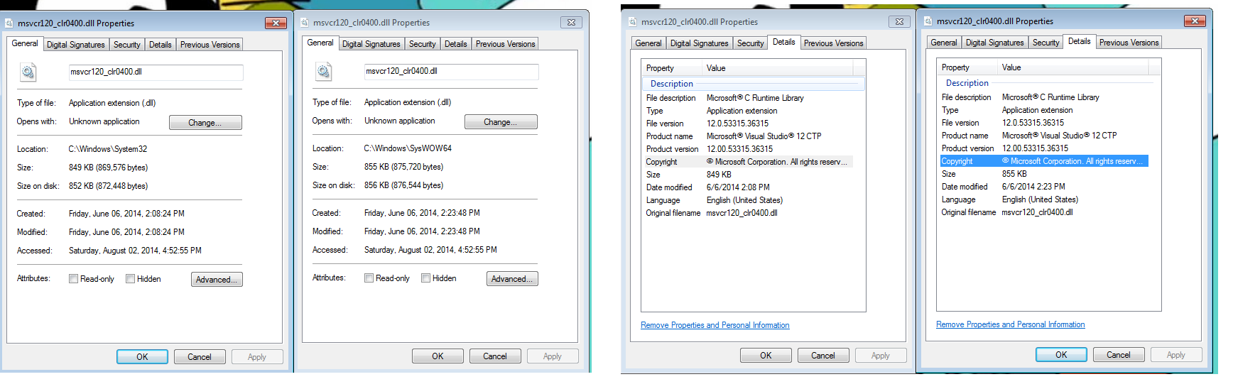

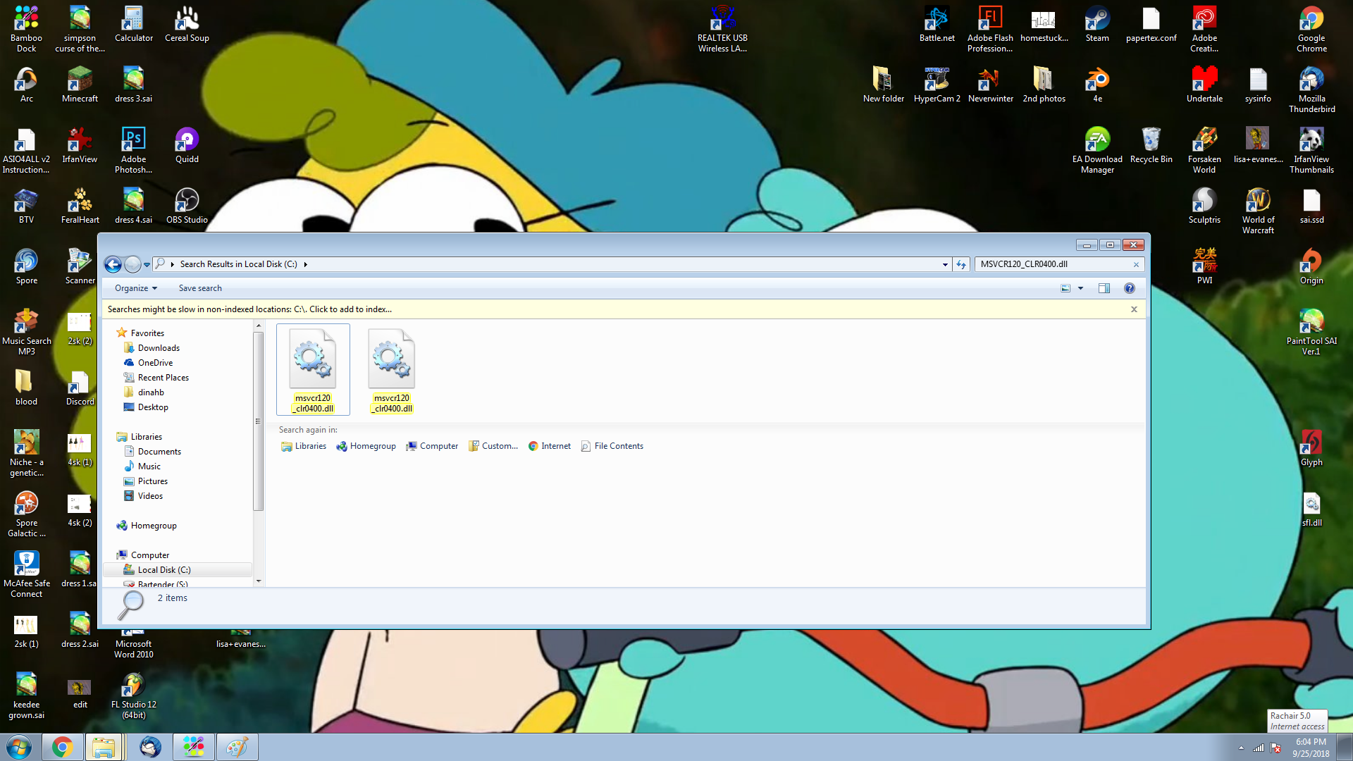

    I did look up the MSVCR120_CLR0400.dll and found this:
    There were two nearly identical MSVCR120_CLR0400.dll. I believe this is because the two affected programs use the exact same MSVCR120_CLR0400.dll, so my PC just created one for each of them. I am unsure if this causes any further issues since I have never seen any of the same file type with identical names being able to be placed in the same location.

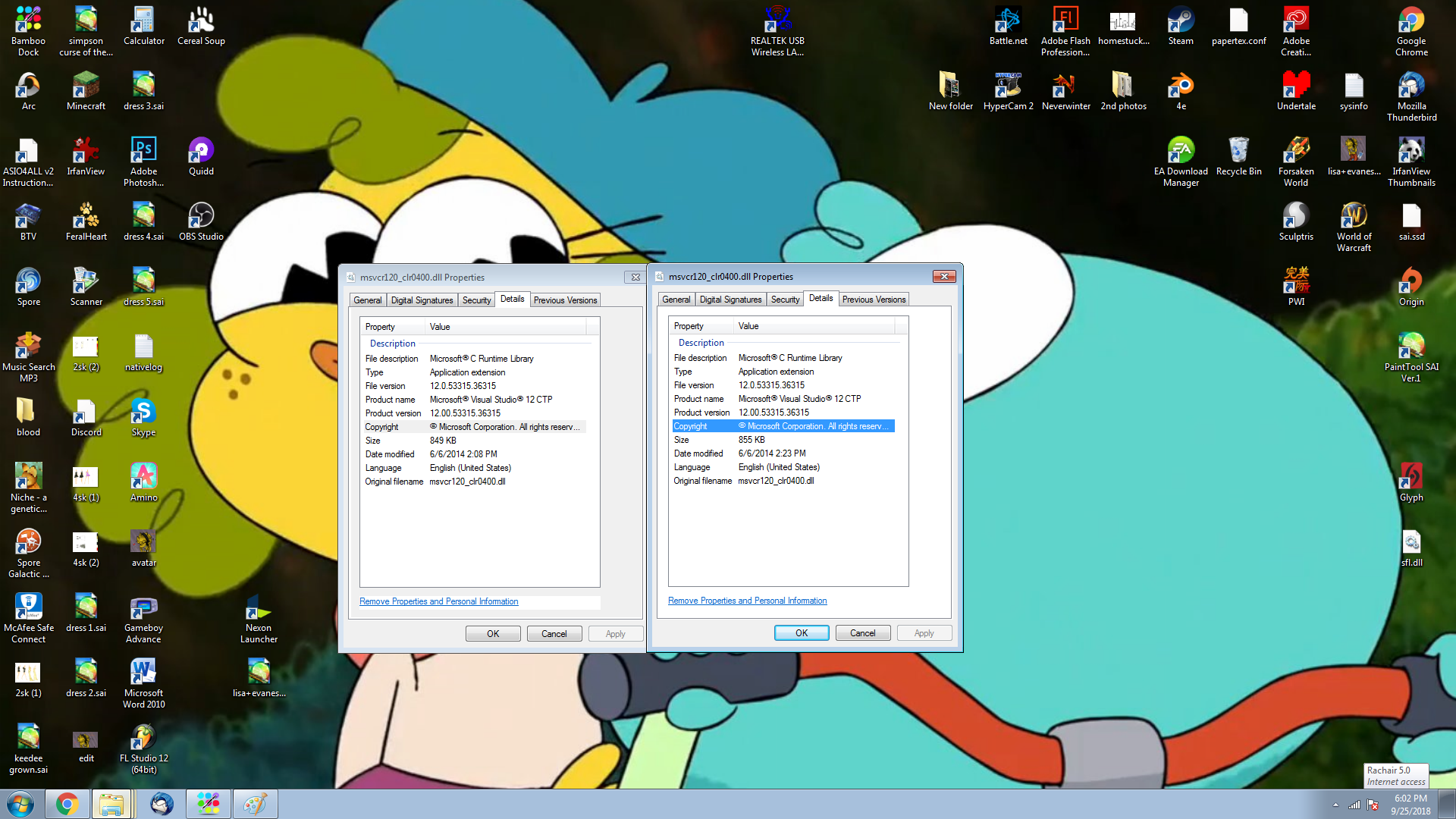

    Everything about these MSVCR120_CLR0400.dll are nearly identical, even down to their properties. There are some very small differences though....The sizes on the disk (and the file size) are slightly different, as well as the time created/modified being similar, but not the same.  Otherwise, they seem to be identical...
    Both of them are version 12.00.53315.36315
