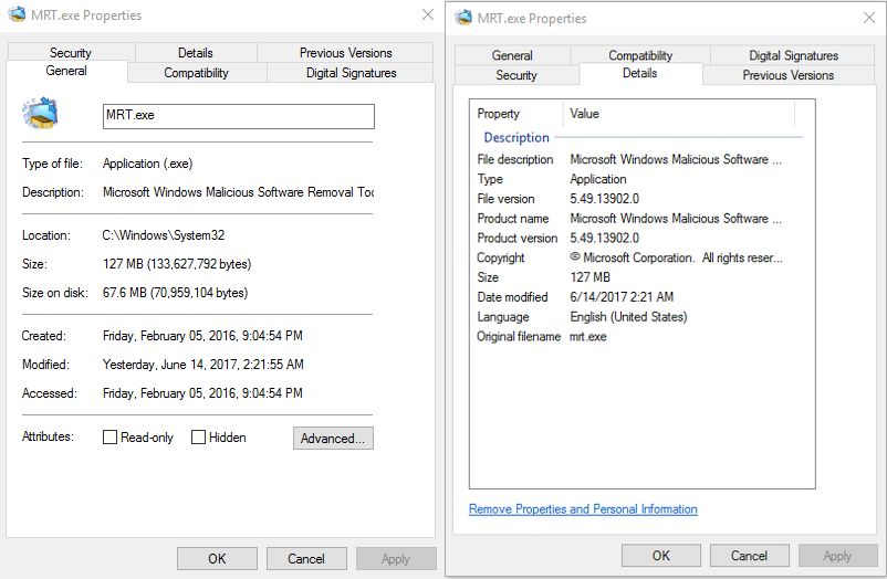

    My own Windows 10 log only contains entries back to April, so it must have been reset when the Creators Update occurred, since it's been Windows 10 since just before the final deadline to upgrade free from Windows 7 on July 29th 2016.
    The file creation date for MRT.exe doesn't change because the file is overwritten rather than deleted and replaced.

    Agreed.
    However, my position is that the OP may have had a part in creating this problem by downloading the tool manually after it has already been downloaded by windows update (and in this case over and over again). When manually downloading it how is it being saved, Save as to a location of choice or if Save is used is it directed to the default Windows location? (Note that the online download is intended for use only for devices that are not receiving the tool from auto update).
    To explain further, I have never manually downloaded the tool, ever. As you can see from the properties dialog of MRT.exe, which resides in my system 32 folder, that apparently the file does not get replaced each month, it gets modified to the current version when downloaded (by Windows update).
    The created date is from when Win 10 Pro v1511 was first installed on this workstation.
    My log file goes back to Aug, 2016 when the v1607 upgrade/update was done (with no problems at all). I have never experienced a problem of any kind with the MSRT.
    What are your thoughts on this?
    -Richard
