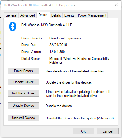

    2018-02-13T14:49:15+00:00
    Just to say,  I had the same issue with a Dell XPS 15.  I updated the bluetooth drivers and it then allowed the xbox controller to pair without issue.
    bluetooth driver:
