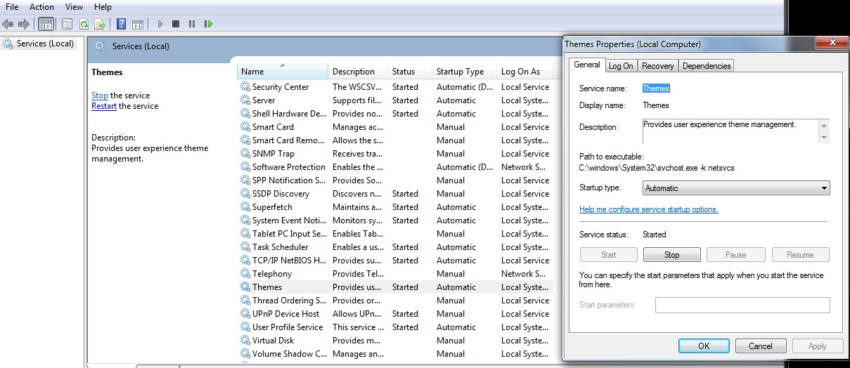

Locate the Desktop Window Manager Session Manager Service, double click it to open the Properties and and be sure the Startup type is set to Automatic and that the status is Started.  Make any adjustments so it looks like the example and click the 'Start' button to Start the Service if it is not running:
Next check the Themes Service which should look like this:
If it doesn't look like that double click the Themes Service to open it's Properties and see if you can start it.

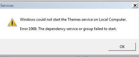

If you are seeing something like this attempting to start the Themes Service:
Or you might see this:

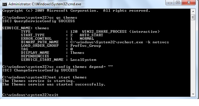

Then issue this command to query the Themes Service:

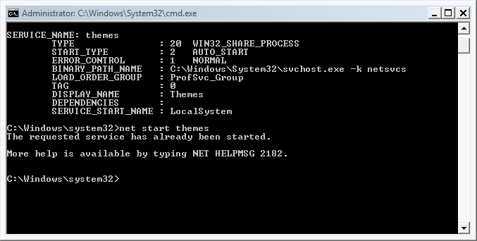

sc  qc  themes
Make a note of what you see listed under DEPENDENCIES so if you need to add something back you will know what that something is.
To help others tell us in your reply what you see on your system listed for DEPENDENCIES.

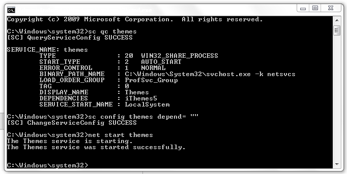

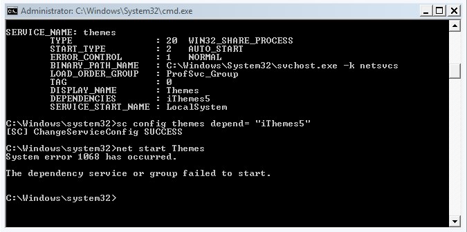

Lately there have been incidents where the Themes Service has a Dependency of iThemes5.  The iThemes5 dependency could have been added by some third party software, malware or adware and if/when that software was removed the iThemes5 Dependency was left behind.
An example of what that situation looks like is here:
Since there is no iThemes5 Service you will see this when attempting to start the Themes Service:
Since the Themes Service has no dependencies you need to remove all the dependencies from the Themes Service.
To do that issue this command being sure to include the space after the equals sign:
sc  config  themes  depend=  ""
Unless something else is wrong now you should be able to start the Themes Service with this command (or from Services):
net  start  themes
