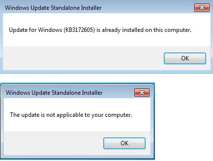

You are now going to download and install either one or two updates manually.  In most cases only the first (KB3172605) of these is needed.  If that produces a result that says the update is not appropriate for you computer, you need to first install the 2nd of these (KB3020369), then install the first (KB3172605).  Choose the one that is for your machine — 32 bit (X86) or 64 bit (X64).

    If you follow the directions and the update fails you should see one of two things (usually):
    You error message is very different (coming from Windows Update I think) so you are not following the directions or the directions are not clear - but even if you do follow the directions it still might fail.
