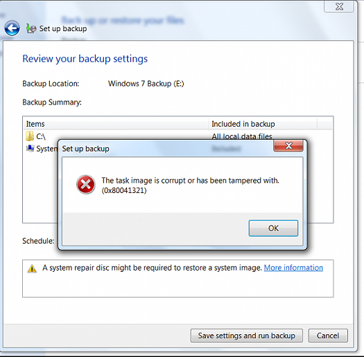

    Sometimes something does go wrong and when I see the 0x80041321 (usually when looking at Backup/Restore) the first question to ask is:
    Did you upgrade to Windows 10 and revert back to Windows 7?
    The error 0x80041321 is not something you will see when Windows Update has a problem - those errors are different.
    The CodePlex solution usually works for most of the Scheduled Tasks but it only works on the ones that come with Windows 7 SP1 so that may leave some unfixed that might have been installed by other things (Google, Firefox, Chrome, Adobe...).  Those you will have to fix by hand or uninstall/reinstall the apps to fix them.
    There are about 80 Windows 7 SP1 Tasks that could be afflicted so if they all don't get fixed it could be that something else is very wrong.
    If it was my system I would bite the bullet and reinstall from scratch so I wouldn't be wondering about what else I'm going to have to find later that is broken.
    For these Windows Updates cases that are troublesome, that might be a good question to ask - did you go 7->10->7?
    If they have done that, a rudimentary quick test is to see it Task Scheduler will open without complaining.  It is doesn't complain with a lot of task corrupt messages that is a good sign.  If it does complain that is a bad sign.
    Remember that folks "trust" that the process from MS is going to work - sometimes it does or it looks like it worked and you only find out later when trying to look at something like Backup and Restore that something is wrong.
    You might need to politely discharge those case where WU doesn't work and you can't make it work if there is also a 7->10->7 in the mix (and suggest a reinstall is the best idea).

    Task Scheduler errors after upgrading to Windows 10 and reverting back to Windows 7 is a known problem.
    The first time folks seem to notice that problem is when they attempt to run Windows Backup and Restore and see something like this:
    In this topic locate the rely about in the middle of page 2 from ElderN:
    https://answers.microsoft.com/en-us/windows/forum/windows_7-performance/backup-problems-after-installinguninstalling/f2969a14-e746-455c-bb8a-07895cc41483?page=2
    If you don't want to waste your time skip all the other ideas and advice.  I can assure you with 100% certainty that none of the advice from the Microsoft engaged alleged "experts" will help with that problem.
    If you need to please start a new topic/question/thread about the Task Scheduler issue since it has nothing to do with Windows Update problems.
