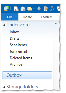

This error arises because you tried to send a message including a photo album. This feature no longer works as a result of changes at OneDrive, where the photo album would have been stored had the changes not taken place. This means that the message is now stuck in your outbox and may be preventing subsequent messages from being sent. The outbox is below the account folders in the folder pane:
Remove any unsent messages from the outbox, then compose a simple test message with a unique subject and send it to yourself. Post any new error message in your reply.
