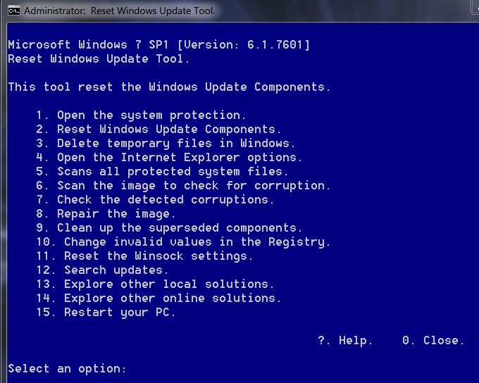

    I personally prefer this one it's much better just a little more user interaction,
    Use Option 2 on the list after right clicking it and select run as administrator
    https://gallery.technet.microsoft.com/scriptcenter/Reset-Windows-Update-Agent-d824badc
    Download it to your downloads folder
    Right click it and select Extract all to the downloads folder.
    Then right click ResetWUEng and select run as administrator
    Follow the rest of the prompts
    Press any key to continue
    Type 2 for that Option on the list and the Enter key to reset update services..
    Press y for Yes and then the Enter key I believe twice
    After it has completed
    Type 15 for that option and the Enter key to restart the machine.
    Should say will restart in 60 seconds save your work.... press any key to continue.
    After restart go to windows updates and manually check for updates shouldn't take a few minutes.
