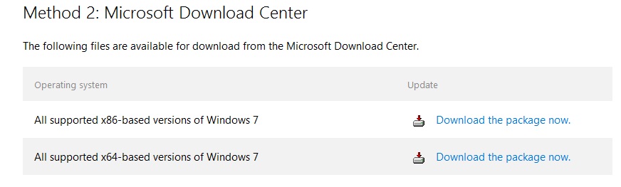

If your installation is new or a reinstall you need to start by installing KB3020369:
April 2015 servicing stack update for Windows 7
If you already have KB3020369 installed you won't be able to install it twice so go ahead and visit this link to be sure:
https://support.microsoft.com/en-us/kb/3020369
If your system is 32-bit download the x86 package.
If your system is 64-bit download the x64 package.
Choose to download the correct package for your system and save the file to someplace you can find it - like your desktop.
Double click the package you downloaded to launch the installer and let it complete.

Next visit this link and choose to install KB3172605:
July 2016 update rollup for Windows 7
https://support.microsoft.com/en-us/kb/3172605
