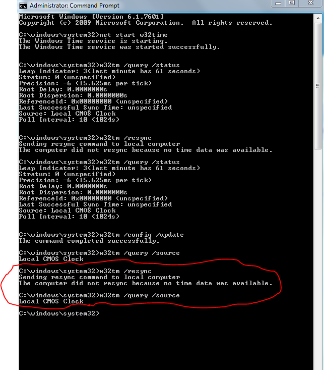

Using administrative command prompt I posted the results of the w32tm /query /status commands.  The first one was with time synchronization off.  The second one was after multiple configure internet time settings update now clicks.  Multiple sfc /scannow were ran that indicated no integrity violations.
At this moment the time delay is 4 minutes and 39.1 seconds behind.
The latest w32tm /query /status displays:  Leap Indicator:  3(last minute has 61 seconds).
What does this mean:  last minute has 61 seconds?
What is Stratum and how come it changed to unspecified?
What is reference Id and how come it is now unspecified?
When the configure internet and time settings is viewed it displays next synchronization 2/25/2016 and it displays the clock was successfully synchronized with the time-nw.nist.gov on 2/19/2016 at 6:19 AM.
How come the date and time indicates a successful synchronized time on 2/19/2016 6:19 AM and the last few w32tm /query /status indicate the last successful sync time was on 2/18/2016 8:11:35 AM.

    w32tm /resync:  Sending resync command to local computer
    The computer did not resync because no time data was available.
    w32tm /query /source:  Local CMOS clock
    2016-02-22T22:30:10+00:00
    Please try this again with the following commands:
    w32tm /resync
    What does the /source command report?

    w32tm /config /update:  The command completed successfully

    how come it did not sync with the sync command?
    Please issue the following commands, pressing <Enter> after each:
    Your clock is drifting by about 16 seconds or more per hour so in clean mode or safe mode you should find out in about an hour or so if the clock holds its time and if the problem is caused by software.
