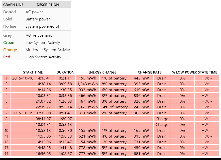

    Thank you for your reply. I have tried the suggested troubleshooting method and tested the device usage for a few days, but the device still has high CPU utilization and it also NEVER, EVER....EVER enters into (DRIPS) Deep sleep.
    The device is a low powered one with the Intel Atom Chipset, 1GB RAM and 16GB Storage, with a 15,751 mWh battery. It is the iView Suprapad i800QW.
    If the issue can be helped that would be much appreciated.

    Hello everyone,
    The issue that I am concerned about is the battery drain of my Windows tablet since upgrading to Windows 10.
    The battery does not last nearly as long as it did with Windows 8.1 and it has greatly impacted the way that would used my device.
    I have used the batterycfg energy-report and sleep study to find out that my device never enters DRIPS (Deepest Runtime Idle Platform State). In fact the device has a change rate on average of 600mW to 900mW, which should never have been so high. rather it should average near the 120+mW range.
    Also the I have a system required request during sleep by a driver: ACPI\80860F28\1  Intel SST Audio Device (WDM) which prevents the device from going to sleep as well as unusually high CPU utilization which keeps the tablet's batter drain higher than usual.
    I have been waiting for a fix for the sleep and battery drian issue to be addressed by on of the Windows Updates but to no avail so far.
    I would like to know how I can reduce the CPU utilization for the specific process that are active and the drive that prevents the tablet from going into deep sleep.
    Does anyone else seem to have tis problem. Leave a reply with any other experiences that you might have on the matter. Thanks for listening.
