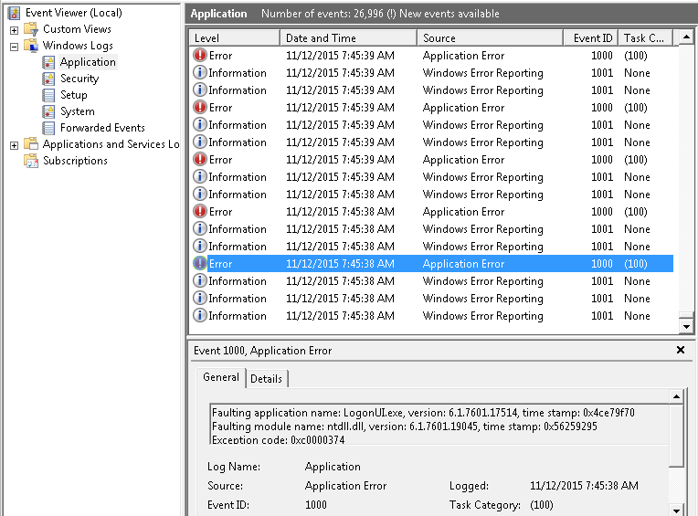

    This morning I have just verified that this problem is a capable of automatic self-repair.
    For this to happen however your computer needs to have already been set to:
    • Automatic updates, install on a schedule
    • Has passed the time to check for updates (it will by now)
    • Stay awake long enough to check for updates and install them
    Though the Application event log is now wiped out on the affected machine, as it has logged thousands and thousands of LogonUI.exe crashes and has completely pushed out all other log data before it.
