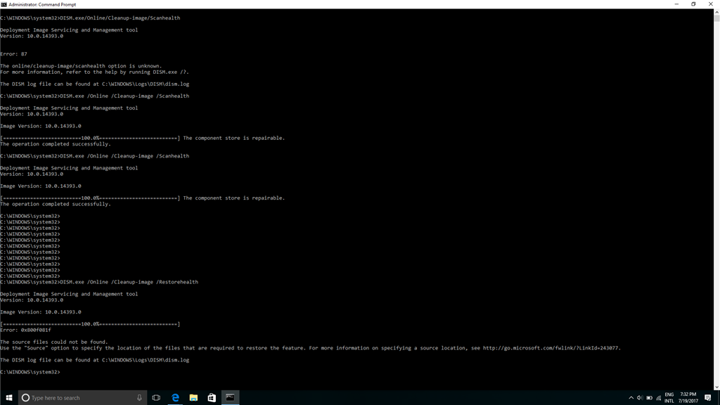

    2017-07-19T18:35:24+00:00
    when I did the restore health this is the error I got.. please help
