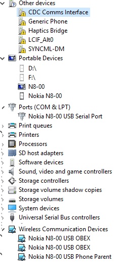

    Do i have the steps correct.
    1. After install of Nokia Suite - reboot PC & Maybe the disconnect and reboot phone as well
    2.  Select Nokia Suite on Phone under USB connection
    3.  Connect phone to PC
    4. Select Mass Storage on Phone
    5.  Wait for PC to install drivers
    At this point which driver failed for you?
    I noted that for a few moments at step 3 above, all the drivers in Driver manager were OK, but after a short period they all ended up with yellow exclamation mark.
    [UPDATE] - works.... sort of
    After Step 5 above
    1. With the phone connected and in Mass Storage mode, Open Device Manager
    2. Select 'View Hidden Devices'
    3. Scroll down and uninstall all the greyed out 'Nokia' devices - if prompted also remove the driver
    see screen shot #1 4. Now change the USB mode to Nokia Suite and voilà, the Nokia Suite recognised the phone and I was able to browse the photos, contacts and message.

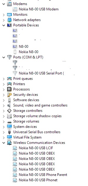

    Down side (see screen shot #2) is that you end up with a stack of 'Unknown Device' in device manager and also, when I tried to reconnect later USB keeps showing up on phone and the dissappearing - but that may be a different issue
    More to come as I work through this
