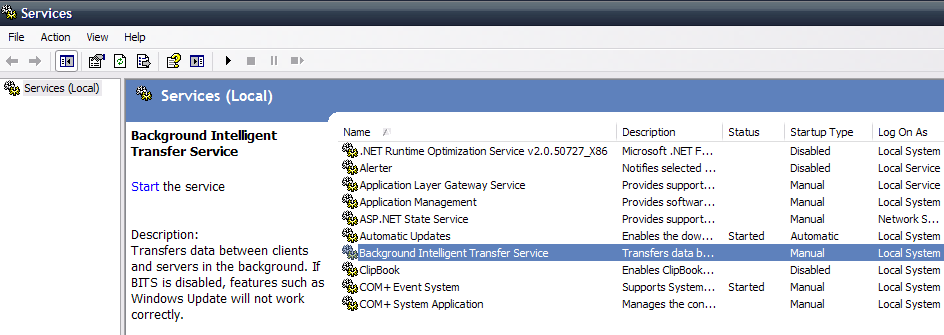

In the list of Services, can you see Background Intelligent Transfer Service ?
Here's a pix of what it looks like.

Restart the PC again and then go to Services and you should be able to see BITS in the list.
Double click it and then on the General tab, click the Start button to try and start the service manually. This is just a test to ensure that it's working correctly.
