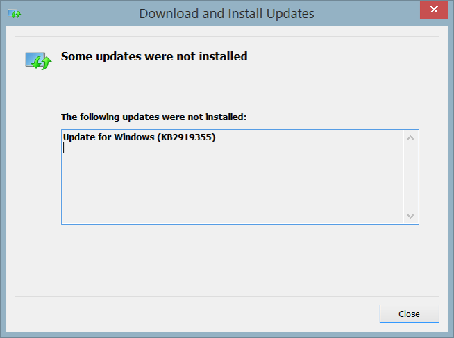

    2014-04-28T18:22:51+00:00
    Hi i downloaded, 64-bit versions of Windows 8.1:  http://www.microsoft.com/en-us/download/details.aspx?id=42335
    But i'm getting that screen withour any explanation.
    Then i try to
    dism /online /remove-package /packagename:Package_for_KB2919355~31bf3856ad364e35~amd64~~6.3.1.14
    DISM.exe /Online /Cleanup-image /Restorehealth
    dism /online /cleanup-image /startcomponentcleanup
    procedures,
    restart
    and reinstall the downloaded package (Windows8.1-KB2919355-x64.msu)
    Result is the same as above window.
