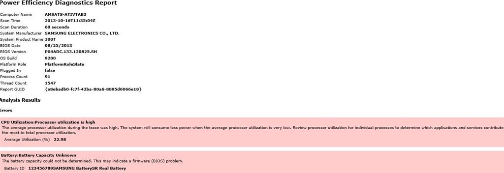

The device was working absolutely fine again, till yesterday evening. Again, the device froze and power key was not working and Windows button was used to unlock the screen after several attempts. Battery was showing 0% despite having 78% charge just fifteen minutes previously. On connecting the charger, battery charge was still at 0% but not increasing. Luckily this time the device did not shut down, but after 3 hrs of connecting the charger, battery has still been at 0%. I would like to know any suggestions to help solve this problem. I tried restarting the APC Battery Controller in Device Manager, but there was no improvement. I am also attaching results of the powercfg command.

    2013-10-16T12:23:05+00:00
    Download and run process explorer to find the app that causing high cpu usage.
    http://technet.microsoft.com/en-in/sysinternals/bb896653.aspx
    Uninstall the faulty app.
    For battery issue install the latest chipset driver from samsung website. Make sure all your drivers are updated.
