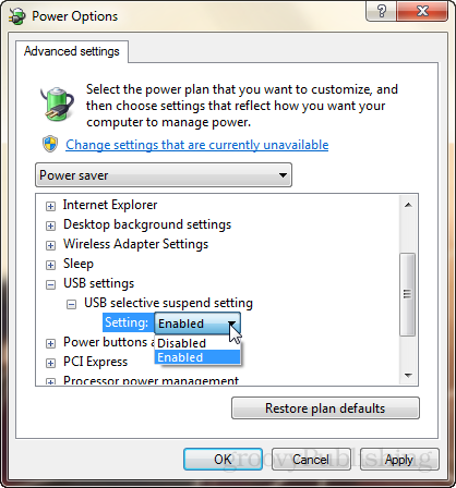

    I have a very similar issue, I am running Windows 8.1 and I have a Seagate 1.5 External drive connected by 3.0 USB. The drive will unmount and sleep when not in use but the drives are still be available under "This PC". So I can still wake them and access files. I can't seem to figure out why it will mount and unmount on its own but the sound is very annoying. Seems to disconnect then reconnect at will. I have tried the following.
        •    Uninstalled 3.0 usb drivers and restarted computer. Drivers reinstalled on their own.
        •    Power Management for USB drives - Disabled Selective Suspend.
        •    Disk Drive Power Options - Never sleep

    2014-07-22T15:57:23+00:00
    I have had the same problem with my Seagate Expansions.Just go to power options and then change the Usb settings to disabled  (power options usb selective suspend).It Worked for me.My disks never go to sleep.( I don't know if anyone solved the problem.I haven't read all the pages I just wanted to help :)
