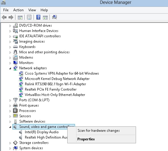

Go to device manager, select the audio device/driver and click scan for hardware changes.
voiala! sounds stupid but works for me.

    Hi Dr Pfeiffer - cannot find an option to scan - can you double check the route to this command ? Are you running win 8 with realtek?
    here..
    This worked for me. Thanks
    Thank you so much! That fixed the problem for me!
