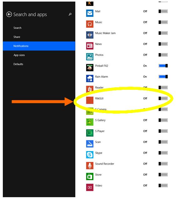

    I tried what you said, but I don't see the "RtkGUI" listed under my notifications.  I did upgrade to 8.1 on my Samsung,  not sure if that would of changed this screen or not.
    I turned off this switch before going from 8 to 8.1 (via store). And the switch is still there in 8.1 and still off. My device manager lists driver version 6.0.1.6865 on Samsung model NP680Z5E-X01US.
    Here is a screen shot of the notification switch...
    Good luck.
    This is a plain (purple) square named 'Settings' on my ATIV running 8.1. No need to fiddle with removing or rollback drivers
