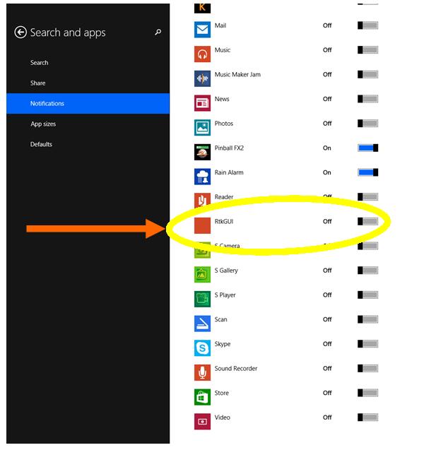

    I tried what you said, but I don't see the "RtkGUI" listed under my notifications.  I did upgrade to 8.1 on my Samsung,  not sure if that would of changed this screen or not.
    I turned off this switch before going from 8 to 8.1 (via store). And the switch is still there in 8.1 and still off. My device manager lists driver version 6.0.1.6865 on Samsung model NP680Z5E-X01US.
    Here is a screen shot of the notification switch...
    Good luck.

    2014-01-27T19:13:50+00:00
    I think I got it. I found there is a notification switch that can be turned off labeled "RtkGUI".
    goto: PC Settings>Search and apps>Notifications>Show notifications from these apps
    There should be a solid orange square (no symbol, just plain orange) labeled "RtkGUI"
    Turn this switch off. The work stopping banner should stop jamming you up.
     ***If you are using a Samsung computer***
    >I would recommend against using a different driver as suggested by others in this thread.
    Good luck.
