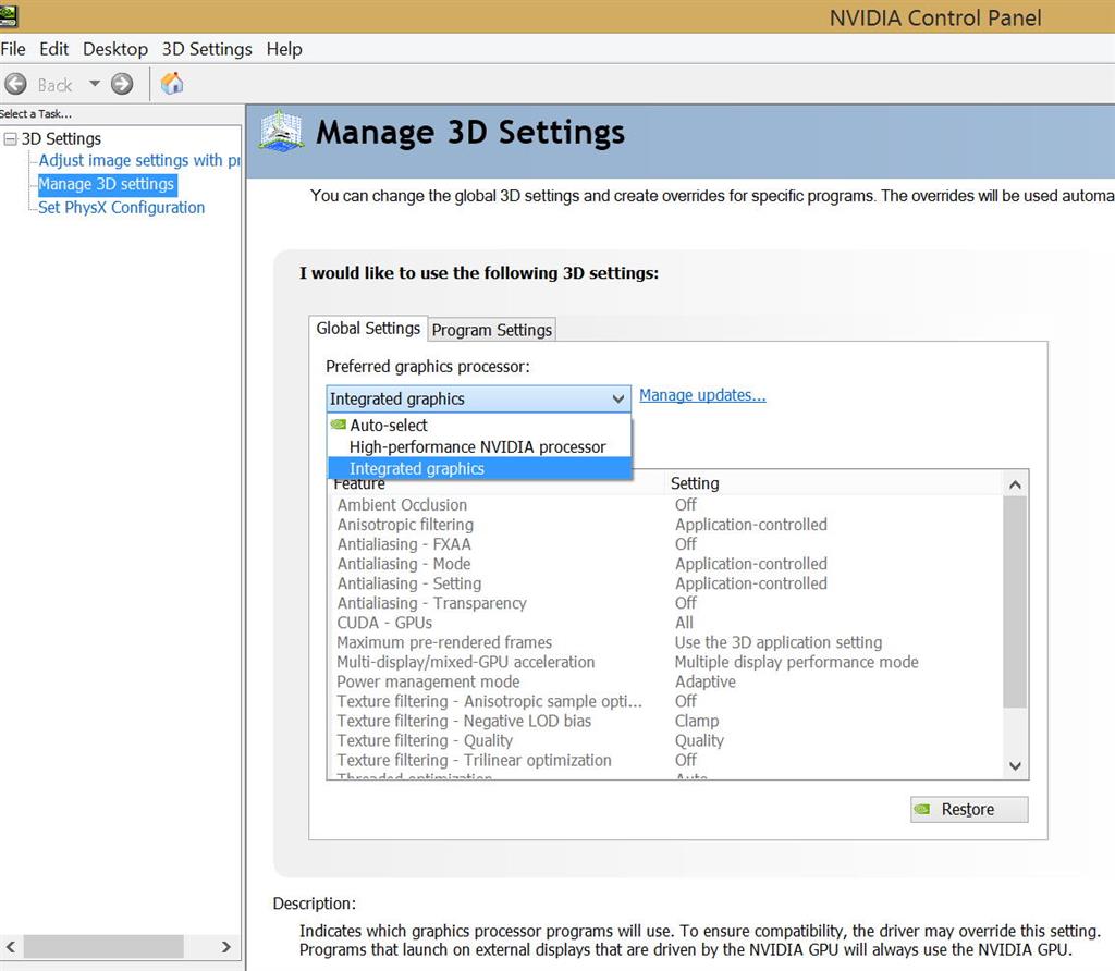

I have seen that it might be a known issue with Windows 8.1, but I can't find a solution anywhere. My laptop has an integrated Intel GPU as well as an nVidia GeForce 740M, and I thought perhaps the problem was that it uses the Intel card as a standard, only switching to the nVidia when necessary, but the HDMI is "controlled" by the nVidia. So I've tried disabling the integrated GPU (to no avail - it just switches to the Microsoft Basic one rather than to the better card - this has been checked through dxdiag), as well as uninstalling and reinstalling the nVidia drivers (which were up to date to begin with). I have checked the BIOS to see if I could change the priorities, but there was no option like I see on my Windows 7 desktop.
