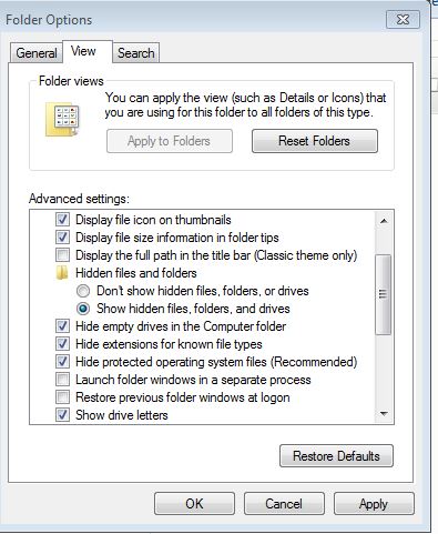

    Hi ,
    If you already remove it using autoruns I would suggest to remove it directly by following the path
    'C:\Program Files (x86)\Search Extensions\Client.exe'
    Press windowskey + E to open Explorer then just follow the path
    If some files are hidden you can click the organize button on the upper left corner of the explorer windows
    hit folder and search options, open view tab
    Below hidden files and folder button tick show hidden files, folder or drives
    Please see screenshot below:
    Hope this helps
