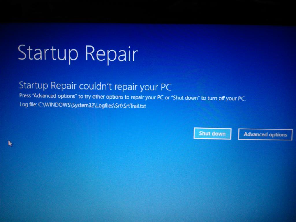

2014-08-26T11:52:41+00:00 Hi
Unfortunately that seems to be what happens if your Windows 8 was an upgrade version and you got the 8.1 update via updates (or you don't have the original build disc).
I had the same thing - I upgraded from Win 7 to Win 8 then of course the 8.1 update was pushed out over the web. I tried repairing the PC as originally suggested and got the same screen.
Anyway, if you are trying to solve the failed first boot issue then just disable hybrid boot. You don't need to "restore" your PC.
My PC works fine now.
2014-08-26T08:27:20+00:00 Hi good afternoon;
i tried the above mentioned steps but its showing the following;
"startup repair could not repair your PC"
Press advanced options to try other options to repair your PC or "shut downto turn off your PC.
Log file: C:\WINDOWS\System32\logfiles\Srt\SrtTrail.txt
