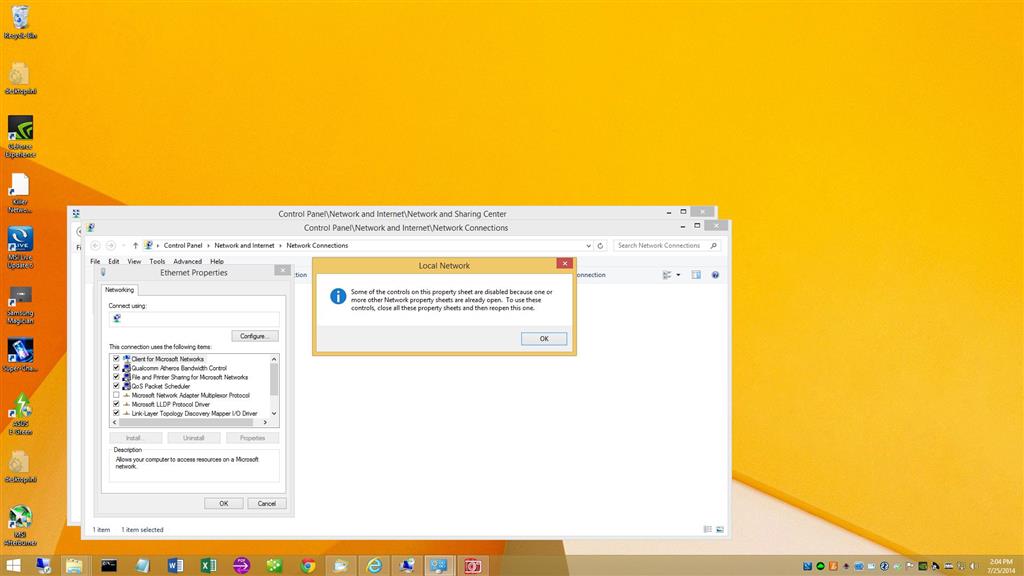

The other new problem I've noticed with this system is that I can no longer change the network properties.  I was doing some tweaking on the network and I wanted to set the PC's IP address to a specific address (instead of using DHCP) and I couldn't change it. That may or may not be related -- I haven't researched it much at this point.

    screen shot of the error message.
    <transcription>
    Some  of the controls on this property sheet are disabled because one or more of the other Network property sheets are already open.   To use these controls, close all these property sheets and then reopen this one.
    </transcription>
    What is the message in the first one?  Are you implying that one is already open that you weren't responsible for?  Can you at least separate the windows before making the screen shot then?

    I cannot I cannot disable IPv6 for the same reason I cannot modify IPv4 -- I get the same error message.  I'm attaching a screen shot of the error message.
