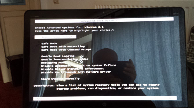

    I ran into this issue a week ago. It happened with a notebook that has the switchable graphics feature. the issue showed itself when I installed the Windows 8 version of the high performance GPU driver and software package. The notebook was delivered with Windows 7, so there was still a recovery partition on the hard disk. I had backed up all of my data before I upgraded to Windows 8 and Windows 8.1.

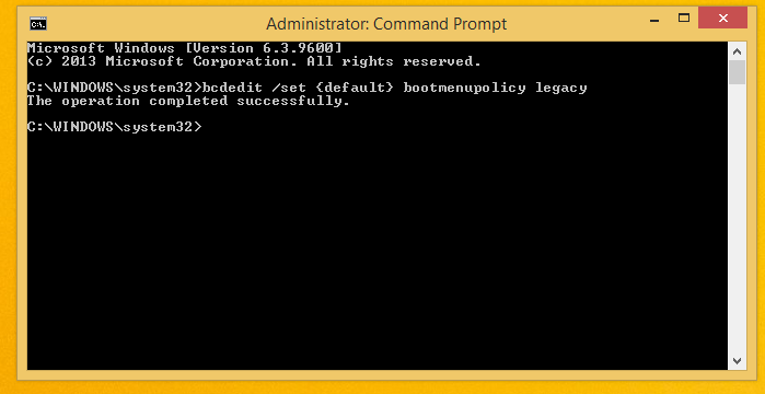

    I used the manufacturer's (HP) recovery manager program to re-install Windows 7 and then upgraded it to Windows 8 and therafter to Windows 8.1. At this point there was still no black screen graphics issue.  I decided that a Windows 7 survival tool by the name of Safe Mode would help if I ran into the issue on the second upgrade attempt. I enabled F8 as a Safe Mode even trigger by using the bcdedit command at an elevated command prompt. I entered bcdedit /set {default} bootmenupolicy legacy and pressed enter
    Once that was done I tested it. I was able to enter Safe Mode without any issues in Windows 8.1 by tapping the F8 key after pressing the power button.
