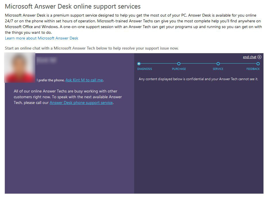

    I got this image 4 times after waiting ~10-15mins each time. i do have other things to do thanks....fortunately my work and my wife's computer is on 7!
