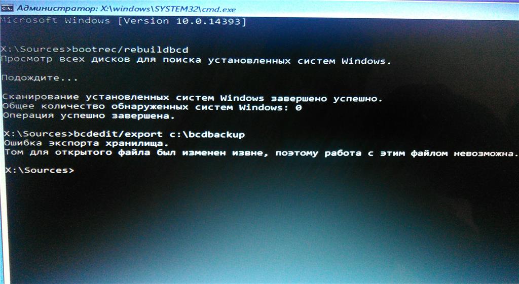

After trying to bootrec/rebuildbcd I find that there are "Total identified Windows installations: 0"
The operation completed successfully.
  1. Since the BCD store exists and lists a Windows installation, you'll first have to "remove" it manually and then try to rebuild it again.
At the prompt, execute the bcdedit command as shown and then press Enter:
bcdedit /export c:\bcdbackup
The bcdedit command is used here to export the BCD store as a file: bcdbackup. There's no need to specify a file extension.
The command should return the following on screen:
Meaning the BCD export worked as expected.
