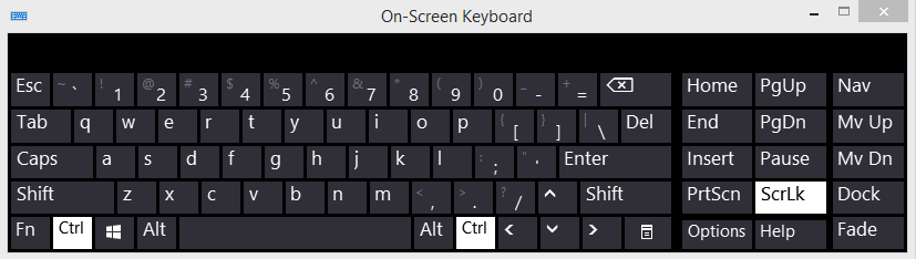

    An even better test is to open your on-screen keyboard. Just hold down Shift, CTRL, or Alt for 5 complete seconds. Let go, and viola it's still selected.
    Thank you, jcross.
    Using the mouse (on the onscreen keyboard) to hold down a key for 5 seconds  also appears to lock the key, which seems to prove this is not a hardware issue at all.
