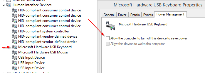

I've found a solution:
Open Device Manager
Under Human Interface Devices, locate the Microsoft Hardware USB Keyboard
Right click, Properties
Power Management Tab, Uncheck allow the computer to turn off this device to save power
That fixed it for me, no need to uninstall/change drivers.

    I had this issue as well.  I am on Windows8.1 with fully updated drivers.  The solution was to uncheck "Allow the computer to turn of this device to save power" in Device Manager->Human Interface Devices->Microsoft Hardware USB Keyboard->Power Management.
    This has been discussed, it worked for some but not for others.
    Confirmed working for me, when nothing else in this thread had.
    Though, I wonder if this will affect battery life on the keyboard itself. I'll post back if there are any side effects.
    Open Device Manager
    Confirmed, works for me, too. (As opposed to my own "change the driver" fix from a few pages back, that did not work anymore after I had to reinstall the machine.)
    Thank you!
