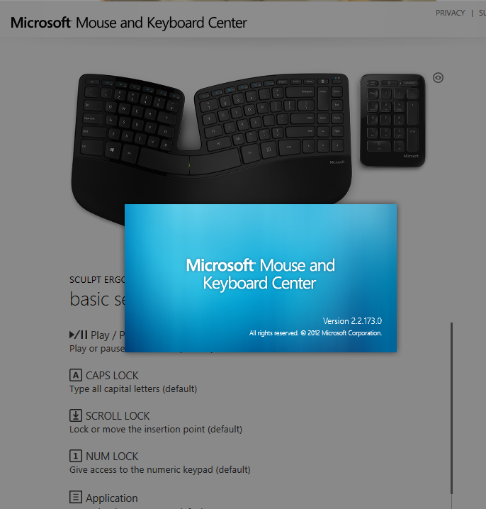

    I also have 2 of these keyboards (home and work) and have experienced this exact sticky modifier key issue at least a few times every day, including Ctrl, Alt, Shift, and my spacebar on occasion. I have only noticed this on the left the side of the keyboard, since that side is where I use these keys more frequently. I have not had this happen with any other key (alphanumberic, tab, etc.) on either of my Sculpts.
    I'm running Windows 8.1 on both machines with the latest Microsoft Mouse and Keyboard Center software (v 2.2.173.0). The software recognizes my Sculpt.
    I own 1 from the desktop+mouse package and 1 keyboard standalone. They were purchased months apart from each other from 2 different retailers. I have read others with similar sticky key experiences, so it does not seem like the ones I own are from a bad batch that passed quality control.
    Could it be that this gorgeous and wonderfully ergonomic keyboard is structurally flawed? Or maybe there's some magic registry or property setting that the lacking Mouse/Keyboard Center software isn't showing us?
