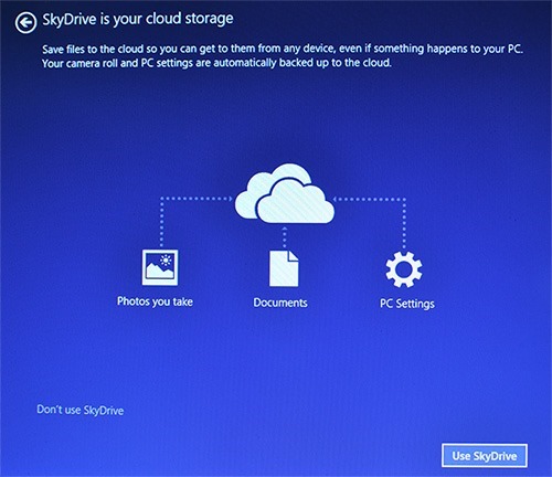

    What I noticed though was, with internet enabled the please wait animation worked, without it the animation froze.  Either way it seems, for me at least, SkyDrive was the culprit.  When I logged in after the System Restore I got this:
    I chose not to use SkyDrive and it has been fine since but I only got the above screen (instead of just the never ending 'Please Wait' (with cancel button) by doing a System Restore.
