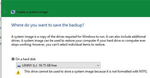

    Windows 10 cannot make a system image onto an external drive that is FAT32.  Windows system images actually contain several separate files and some of them can be as big as 8GB.
    I have just tried using a FAT32 drive for a Windows 10 system image and it refuses to run.  I ran the test on a 64 bit computer & on a 32 bit computer with the same result.  However, I do not think that is the cause of the current problem because it gives a clear explanation for the failure to proceed -
    I think the fact that the Desktop made an image onto the external drive proves that the drive is sound & that it is already formatted to NTFS.  But, providing you save the files on it somewhere else, reformatting it will do no harm.
    The external drive will work on both your Windows computers whether you choose NTFS or FAT32.  It is just the system image constraint that forces you to choose NTFS.
