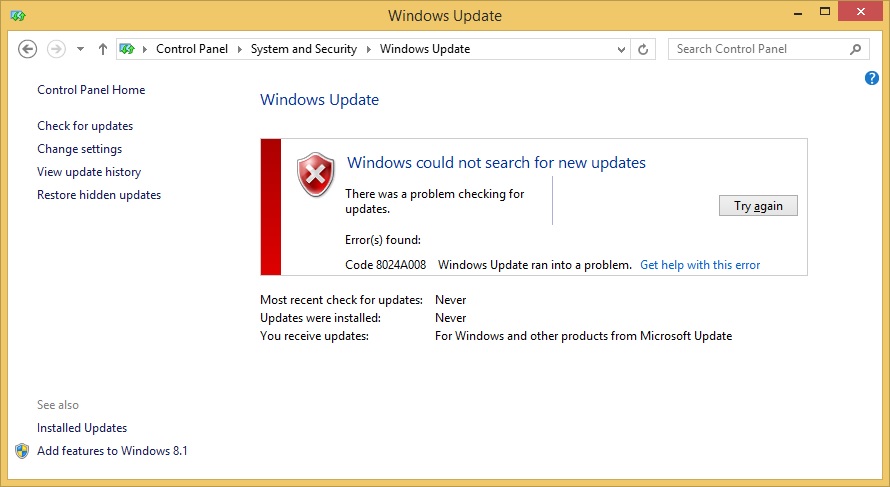

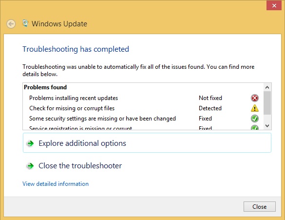

Hey, I just upgraded my computer from windows 8 to windows 8.1. After the installation I tried to run the Windows update and after sever minutes of checking for updates the following error occurred "8024A008".  I tried several methods to solve this, first of all I restarted the computer but nothing changed, then I ran the "Windows Update Diagnostic" tool with no luck either. I'd appreciate any advice on how to solve this problem. Thanks a lot!
