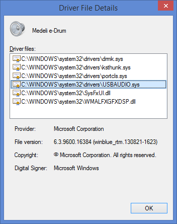

    The USBFlags registry key "0A6710110122" for the Medeli e10 keyboard "Medeli e-Drum (USB\VID_0A67&PID_1011&REV_0122)" was there and did not have the binary "osvc = 00 00" set.
    Adding the binary and restarting the keyboard solved the problem. Eliyas Yakubs solution works for me.
    Thanks!
    Original Response:
    I can partially confirm your findings. My failing system has the 6.3.9600.16384 driver and windows update says all drivers are up to date.
    I'll see if I can find machines with Windows 8.0 and USB 3.0, and with Windows 8.1 and USB 2.0 during the day.
