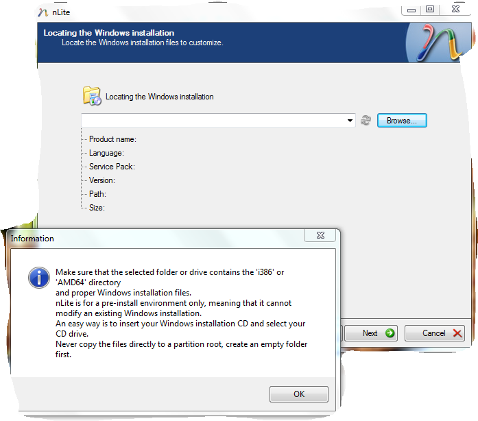

    *** I have now tried using nLite to slipstream the cd and when I do either choosing the OEM disk from the cd rom or from a file on the desktop I get this pop up
    then instead of choosing the whole xp folder I created and put the files from the disk in, I navigate farther into the folder to the i386 subfolder and choose it, and I get the same pop up message.

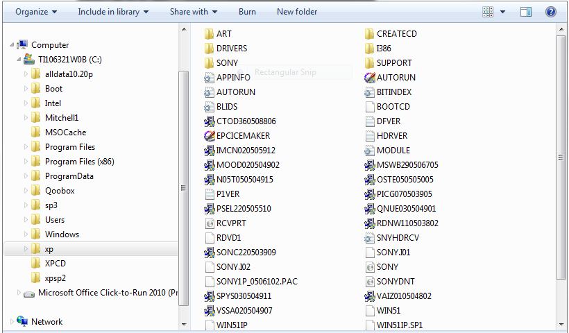

    I have copied the contents of my OEM disk to the desktop of the windows 7 laptop. I can see from the list of files that sp1 is on the disk.  I think my best bet is to slipstream it with sp2 & sp3for safe measure, since the xp home laptop has sp3 installed on it? Are these good directions to follow? because they say sp2 and hotfixes that came after sp2, but I think before sp3. They also say this
