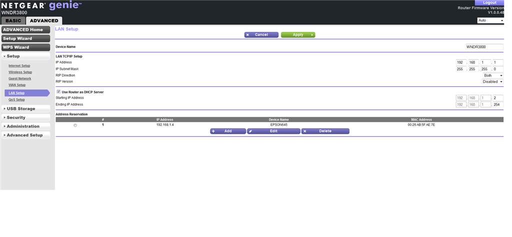

    2014-03-29T03:45:15+00:00
    Just tested it and it reconnected to the same ip. Thanks for your help.
  4. LemP 74,985 Reputation points Volunteer Moderator
    2014-03-28T18:28:52+00:00
    Yes, that looks right.
    Your router defaults to permitting the DHCP server to use any IP address in the subnet, but the router also has the ability to "reserve" an IP address so that it isn't one of the addresses that might be automatically allocated.
    You have "reserved" 192.168.1.4 for your Epson 645 -- and that is the same address currently being used by the printer ... so if the printer works now, it shouldn't have any problems reconnecting.
    2014-03-28T18:08:36+00:00
    I think I have done it correctly. My router is a Netgear WNDR3800. Does this look right?
    My printer is an Epson Workforce 645. I couldn't figure out how to manually assign the IP address in the printer itself but it is currently using that IP (192.168.1.4). Will this be fine for when the printer needs to reconnect?
