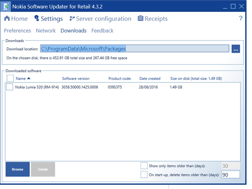

    2016-09-03T20:52:37+00:00
    Yes, I could not log in either and had to work offline. I had the same issue you have highlighted and it took a while to find the solution. You need to select Settings from the menu at the top of the screen (next to Home.) From there select the Downloads option below Settings. From here I had to change the 'Download Location' to where the Software was saved on my PC. This was stored in 'C:\ProgramData\Microsoft\Packages' on my machine, this was saved there by the Software Recovery Tool I think. Once this is updated correctly you will see the software listed on this same screen (i.e. Downloads screen.) Once you return to the screen that shows your phone details, as you've shown above, you are now given the option to reset the software. The Product code and Software version you have there are the exact same as mine, and the fact it shows the IMEI number as well shows that you are oh so close to solving the problem!
    Good luck and apologies for delay in replying.
    2016-08-28T12:25:22+00:00
    Thanks and I've downloaded 4.3.2 but when I run it I get 'Connect to server' which wants an ID & Password which I haven't got so I choose 'Work Offline'
    I connect phone when it asks me and it wakes up the phone
    The word NOKIA is displayed on phone in capital letters but then pc screen says 'Software package not found on disk' and also 'Package check for the selected phone failed' although earlier a message reported software installed ok
    Did you work offline and what is the significance of logging in? I assumed this was a stand alone  tool?
    I click OK and the next screen does show my phone details as:
    Name Nokia Lumia 520
    Type RM 914
    IMEI 358106050195976
    Product Code 059S3T5
    Software version 3058.50000.1425.0006
    Any comments appreciated
