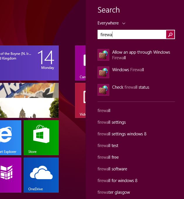

    • I went to the main screen and searched on "Firewall"
    • Clicked on the 'allow an app through the firewall - see below.

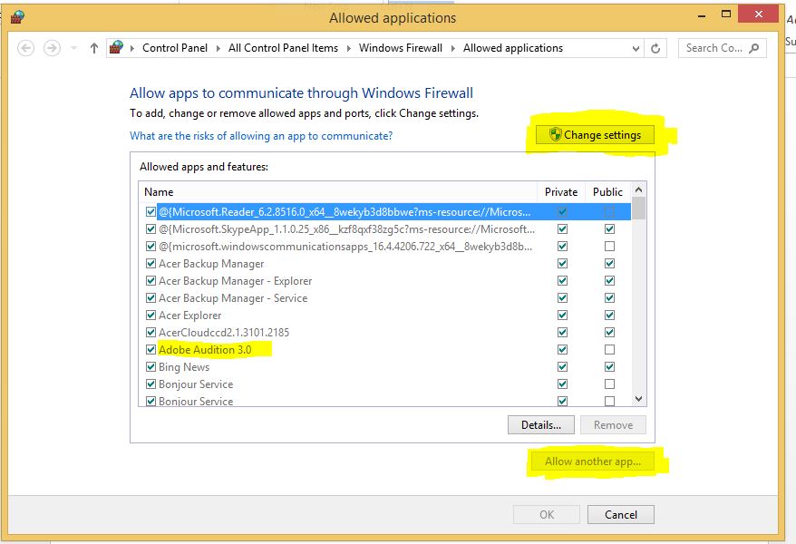

    I use Adobe Audition and that wasn't listed in the apps in the box below so I clicked on
    "change Settings" see below
    Then "allow another app" and I added adobe manually.

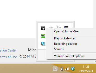

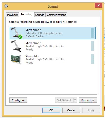

    Right click on the speaker icon and then select Recording Devices in the menu below.
    Double click on your USB Mic

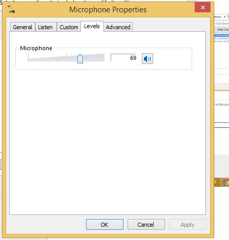

    Select the "Levels" tab and make sure it is set at an adequate level. (just in case anyone thinks that it is this level setting that fixed the issue rather than the firewall settings - believe me I tried all of this before and nothing worked)
    I really hope that this helps someone.
