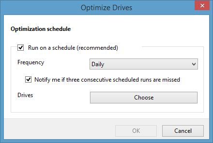

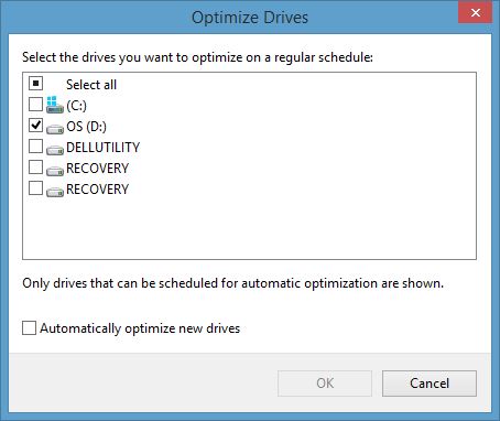

I was having the same error. I hope this fixes it, as has been suggested, but this is what they meant:
Right-click any drive. Choose Properties. Choose Tools tab. Choose Optimize. Under Scheduled optimization, choose Change settings. Beside "Drives" click Choose. This is where you can deselect the partitions you wish to exclude, such as Recovery partitions.
EDIT: I did the above, but I still get the same error if I optimize my non-solid-state D: drive:
"The volume OS (D:) was not optimized because an error was encountered: The parameter is incorrect. (0x80070057)"
Also, running at CMD prompt, running "defrag D: /V /U" errors after 3% complete with the same error:
