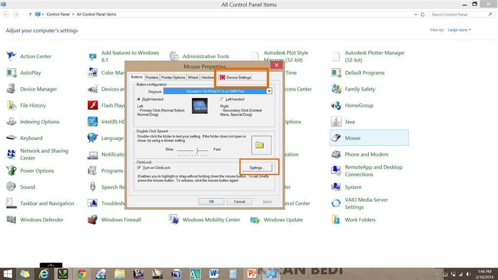

    2014-02-10T19:48:04+00:00
    Can you explain what this red box looks like? I get to the mouse properties window and can't find it. What tab is it under?
