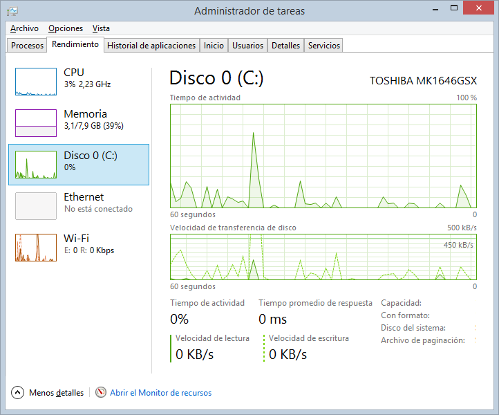

Hi There,
Since I upgraded to Windows 8 (in January), I have intermittently experienced freezes, and general performance dips. Upon investigating I found that when this occurred, my Hard Drive was showing as 100% Active Time, with a low Read and Write Speed (could be as low as 10 KB/s or as high as 40MB/s) and an Average Response time well into the 1000's (ms).
This is an example https://dl.dropboxusercontent.com/u/23428568/100%25%20HDD.png.
The same thing happens on all the Hard Drives when they're in use. Since it originally started happening, it has only become worse and more frequent. I had thought it may have been a heat problem, but it never gets above 40-50c on the HDD.
All in all.. i'm very confused and really looking for any help you can provide because it's really affecting my daily usage...
Computer Model - Alienware M15X Laptop
OS - Windows 8 Pro 64Bit
Thanks in advance :)
Oliver

    After more than 6 months of suffering, cursing, downgrading, upgrading, formatting, reinstalling and all sort of pagan rituals, I decided to give a try and get a new hard drive.
    I installed Windows 8.1 from scratch and it seemed to do the trick (two weeks and counting...)
