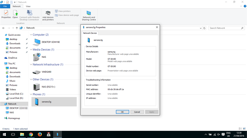

    2016-04-21T11:27:44+00:00
    Edited: I have now Bluetooth hardware disabled and a different phone appeared today in "network" folder.
    Looks like I was wrong and it isn't Bluetooth.
    I have had the very same issue since I've upgraded to Windows 10 Pro.
    A stranger's phone occasionally appears in "Network" folder under "Phones". The name of the device not always the same. It sometimes comes and then goes.
    I have contacted Microsoft support about it and they have connected to my PC through remote control and ran several checks to find the issue. But they could not find the cause.
    However I got closer to the answer. Them devices are Bluetooth devices. If you go windows settings and disable Bluetooth nothing will change. Them devices will show up again and again. But if you go to device manager and disable the Bluetooth hardware then you will never have them strange devices showing up in "network" folder.
    This is something really strange. I have contacted Microsoft support today again and told them about it.
    They have run multiple checks again and couldn't find a thing again. They have seen the stranger's phone appearing in my "network" folder but couldn't tell why.
    At the end of the chat they have said they going to investigate it further and thanked for the information I have shared with them.
    At the bottom line. Just disable Bluetooth hardware in device manager.
    Before anybody asks.. Yes I have scanned for malware and viruses. I have real time security application.
    Kaspersky Total Security. I have a Virgin Media broadband with their "Superhub 2ac" and yes I have a password on my wifi. WPS is disabled. I have checked all logs possible and found NO unknown activity on LAN (or wireless).
    Hope it helps some!

    2016-04-20T04:13:35+00:00
    First half of the answer is correct the other half is completely WRONG though.
    FWIW, disabling the modem's WPS worked.
